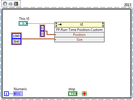

Or if you do not really want to use two separate VIs, you can just resize one VI programatically to fit both screens, from position 0 to position 1080,3840 (assuming 2 x 1920*1080 displays)
