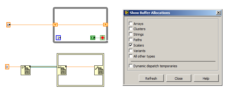

When trying a simple stupid experiment, LabVIEW shows it allocates new memory for every access to the reference.
Is this OK? (I had problems with passing those large data through terminals from function to function or VI to VI, where these dots also appeared)
