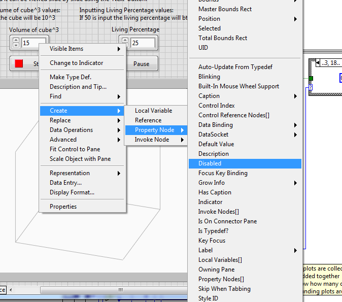

I explained how to create the property nodes but maybe I wasn't clear.  Right-click on the control you want to create a property node for.  This brings up a menu.  Select Create|Property Node|Disabled.  Here's a picture:

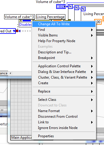

After that you can right-click on the property node and select Change All to Write.

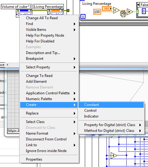

Then right-click on the property (Disabled) and select Create|Constant.
You can now left-click on the constant and change it to Enabled, Disabled, or Disabled and Grayed.
