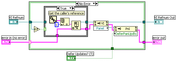

Usually, the way to handle this is to check the error in terminal and if it is has an error to pass the error instead of executing the code. That way, when you have an error, the rest of the code does not execute. Here's an example:
