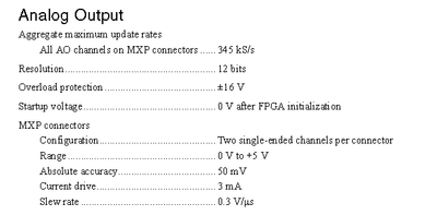

Most of these examples use I16 data type where as IO node on myRIO 1950 accepts U16 data type. I have used two methods found on forums to generate sine wave (works great in simulation) but the output is always I16 and if connected directly to the IO node it shows a coercion dot. I used a conversion vi I16 to U16 to avoid coercion dot but that does not change the output. (Below is a snapshot from myRIO 1950 manual)
It reads that IO node is of 12 bit resolution, so attempted to use logical bit shift. It does changes the shape of waveform (from some what sinusoidal to square) . But not sure if that could lead to some solution.

The AO of the myRIO has a range of 0…5V, with 12bits resolution. So an U16 value of 0 outputs 0V, and 2^12-1=4095 outputs 5V.
To output the sine signal you have to scale your calculated values into this integer range of 0…4095!
So the scaling from a range of ±1 (sine signal) will be
y = (x * 2047) + 2048
Also note those "absolute accuracy" and "slew rate" specifications, both may influence the accuracy of your sine signal…
