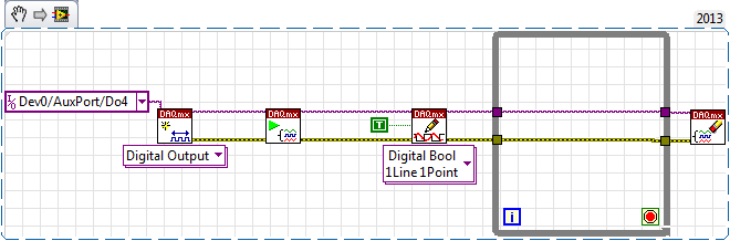

How are you connecting the force plate connections to the usb-6008? I use the kistler plate with labview all the time, however I use a 25pin connector to the kistler box that came with the force plate. In side the box is a measurment computing 1616 FS, which we can program however we want in labview. In our case we have to write digital pin 4 high before entering the while looop that is used for data collection. If you know the pin or have a bare wire, then just connect it to a digital line and use the DAQ vi's to create the channel and then use digital write to pull it high. This is very similar to how you would create analog channels for data collection. I don't know what DAQpad is, so I can't help you there. Hope this gets you moving in the correct direction. See example below, you will have to pick the correct digital channel. Another thing to do is write the digital pin Low after the while loop is over, just so the pin does not stay high (put it before the end task)write digital high.png

I did as you suggested turtl, and first I tried to write a high to only 1 pin (the operate/reset pin). When that didn't work, I tried to send digital signals through all 6 pins. That also did not trigger the foot force plates to start acquiring data. Right now we're not sure if 1) we're sending any digital signals at all or 2) where we are supposed to be sending the signals to. I have attached the connection requirements for the control box, as well as the two new VIs. (Previously, we were using the express VIs to output the signal).

As I said, no need to write any code, though I don't see anything wrong. Use the test panel and first check directly at the output of the 6008 and then the output of the cable. You setup the device to output on line 0 of the DAQ device. Physically wiring this to the DB9 is up to you. This is really pretty basic troubleshooting.
