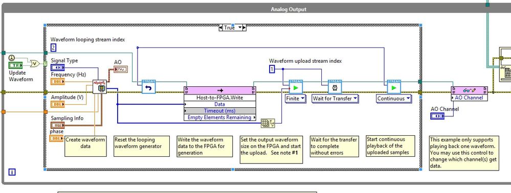

In this example host VI, look at the analog output loop, you will see there is a case structure used to generate sine output signal. In the true case, you give control to the signal's amplitude, frequency, and phase.
Figure 1. true case structure

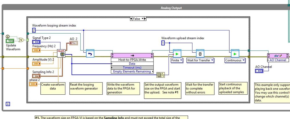

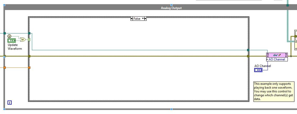

In the fault case, there are no functions in the case, that means if the case is fault, we just keep the true case parameter in memory without any change and use it.
original fault case.JPGoriginal fault case.JPGoriginal fault case.JPGoriginal fault case.JPG
Figure 2. Original fault case structure
It works well. I can generate a sine signal successfully. But for my system, now I need to make it as a closed loop system.
The basic idea is I directly wired AO of NI 5783 to the AI of it (Let's just assume the cable is my plant). On the AI side, using CORDIC method, I can calculate the amplitude and phase of the feedback signal, and then I use a PID controller to control the amplitude and phase, after that, I want to use the feedback amplitude and phase value being controlled to be the new setpoint for the amplitude and phase control of 'create waveform.vi'. That is to say, the setpoints are always changing every single loop. As a result, for the 'fault case', the change I made will be copying all the code in the true case and make the controlled feedback value to be the new phase and amplitude setpoint.
In the fault case, ensuring the setpoints can be updated every single loop, instead of using the real feedback value, as simulation, I use control values to be new setpoints for amplitude and phase to see if my thought works well using FlexRIO:
Figure 3. Modified Fault case structure
The result is that the AO cannot output a good sinusoidal signal. For example, if I set the frequency to be 25MHZ, the output waveform has a 25MHZ signal, but also with variable frequency harmonics(lower or higher than 25MHZ, close to 25MHZ stronger). So I wonder if it happends because these streaming things and FIFO cannot support the data is updated every cycle...
I have asked person in NI about this, they say this kind of FIFO structure might not be realizable, they asked me to generate waveform point directly at FPGA side. But using that way, for the reason that I need my FPGA loop to be updated quickly, it's hard to generate points in a single cycle timed loop without timing violations in FPGA VI.
So I want to ask if there is anyway to realize my thought using the FIFO and streaming structure? If not, any other good ideas?

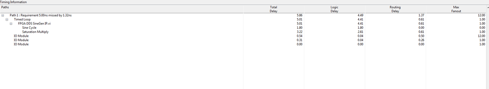

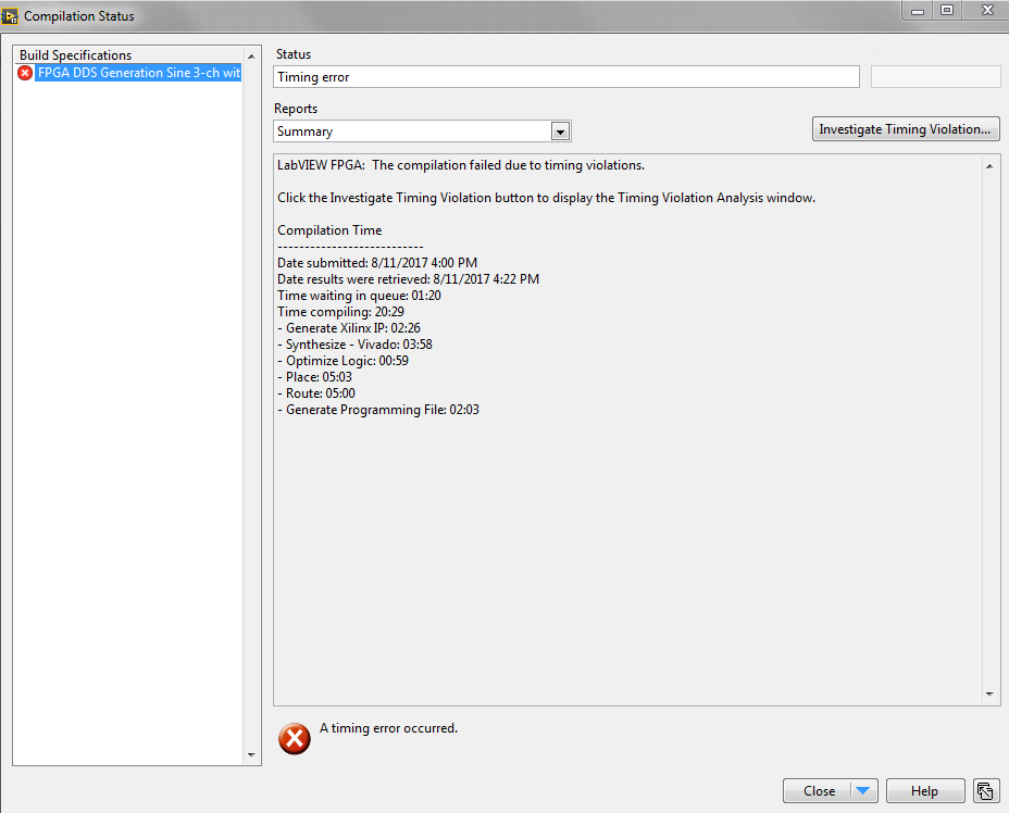

The struggling is when I put waveform generation code in to FPGA VI SCTL, the compilation fails. It has the timing error.
modified FPGA VI.PNGmodified FPGA VI.PNGtiming violation error.PNGtiming violation error.PNGtiming violation.PNGtiming violation.PNG
you can see that the timing information shows the requirement for the SCTL is 5ns, that means 200MHZ. However, my data clock is 100MHZ now, so it does not make sense.
Thank you

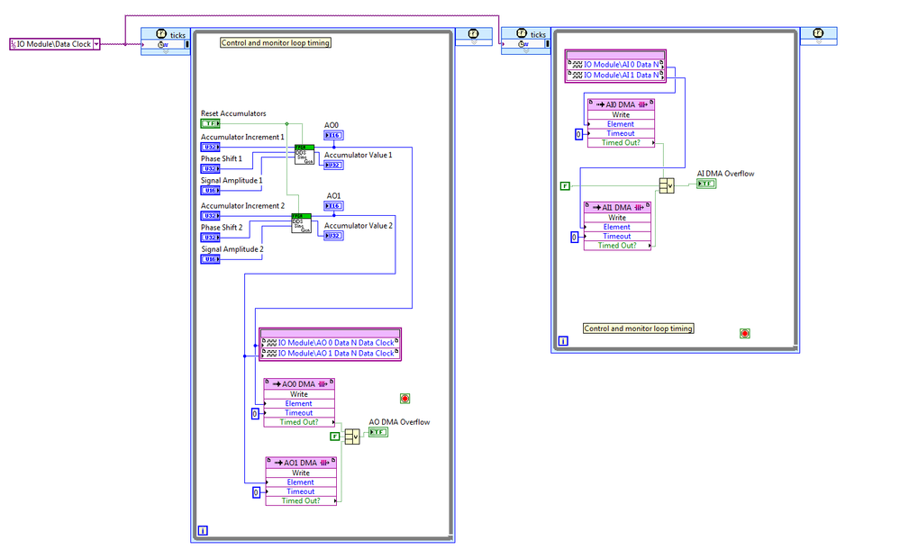

Try pipeling your design so that you don't have to fit everything into a single cycle. The High Performance Developers Guide provides some guidance on how to do this.
The section that starts on page 27 titled  "PIPELINING YOUR DESIGN" is where you'll want to start: https://www.ni.com/en/support/documentation/supplemental/13/the-ni-labview-high-performance-fpga-dev...
The DDS vi alone has a 5ns data path delay. If you open that up and add some pipelining between components you should be able to compile at higher frequencies.
Message 8 of 12
(7,033 Views)
Hello David,
Thanks for replying.  I already pipelined the DDS VI and main VI, now the code can be compiled. However, for the "look up table 1D" VI in DDS VI, if you select the interpolation mode, it takes at least two cycles no matter how you pipeline the DDS VI. If you don't choose it to be interpolation mode, my output signal is very bad (only have 4 points).
Message 9 of 12

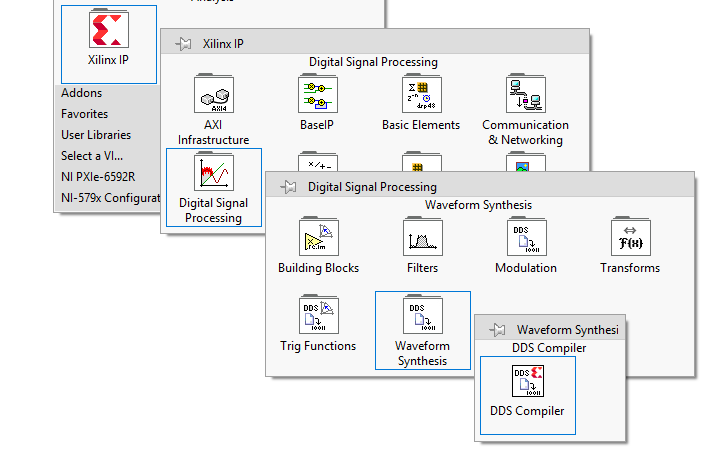

Direct Digital Synthesis has varying levels of complexity depending on what you're trying to do. Rather than work through them yourself, have you considered using the DDS Compiler via the Xilinx IP that is accessible from the functions palette menu in LVFPGA?
