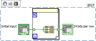

Why not use a loop like this:
(You might also get away without loop and/or excessive IndexArray/InsertIntoArray functions!)

- NEVER insert into an empty array. Whenever you (think you) want to do this you should use BuildArray…
- Learn usage of loops, the autoindexing in loops and usage of shift registers in loops. This will help you handling arrays a lot!
