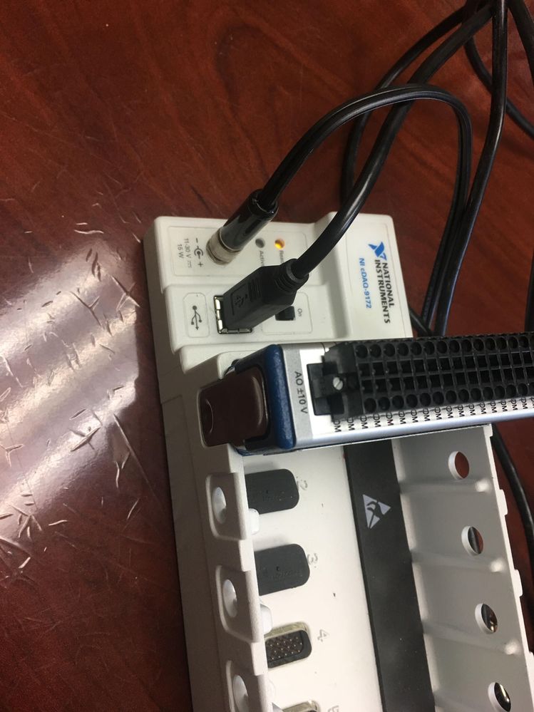

Actually, I noticed that I was using the incorrect instruments. I just want to generate a voltage signal.
I attached a picture of the instruments.

To help resolve issues with your code we need the code.  Where is that Analog input module and how come there are no wires?

Hi SilveKarel,
Reiterating Jeff's point, we really need to see your code to have a good idea of what is not configured properly in your system. If you could attach the .vi file, that would be very helpful.
I'm also not quite sure what you mean when you say you were using the wrong instruments? I would encourage you to take a glance at documentation on the devices you have to better understand their functionality and limitations.
NI-9172 - This is a chassis that organizes the instrument modules inside of it. It does not acquire or generate signals on it's own. The manual is linked below:
https://www.ni.com/docs/en-US/bundle/371747f/resource/371747f.pdf
NI-9201 - This is an analog input module. It can acquire signals by reading in voltages. It cannot output signals.
https://www.ni.com/docs/en-US/bundle/ni-9201-specs/page/specs.html
NI-9264 - This is an analog output module. It can generate signals by outputting voltages. It cannot measure signals.
https://www.ni.com/docs/en-US/bundle/ni-9264-specs/page/specs.html
You'll want to have the 9264 in the 9172 chassis, which appears to be the hardware configuration in your picture, which is a good first step. There are other modules that NI provides that perform similar input and output functions, but with varying spec, like channel counts or voltage ranges. You don't necessarily need to have the same modules used in the video to be able to perform basic signal generation.
