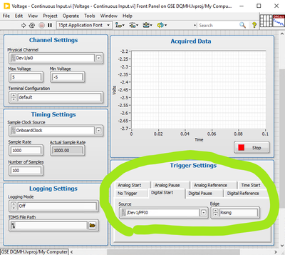

Have you tried using the Voltage - Continuous Input that comes with NI DAQmx...
Id suggest using Digital Start tab and then select as Source the pin where you connect External Source
