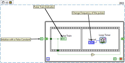

Hi Ammar,
Here:
Now all you have to do is create a parallel loop to count the number of rising or falling edges, you can do this by comparing the current and previous values with a shift register.

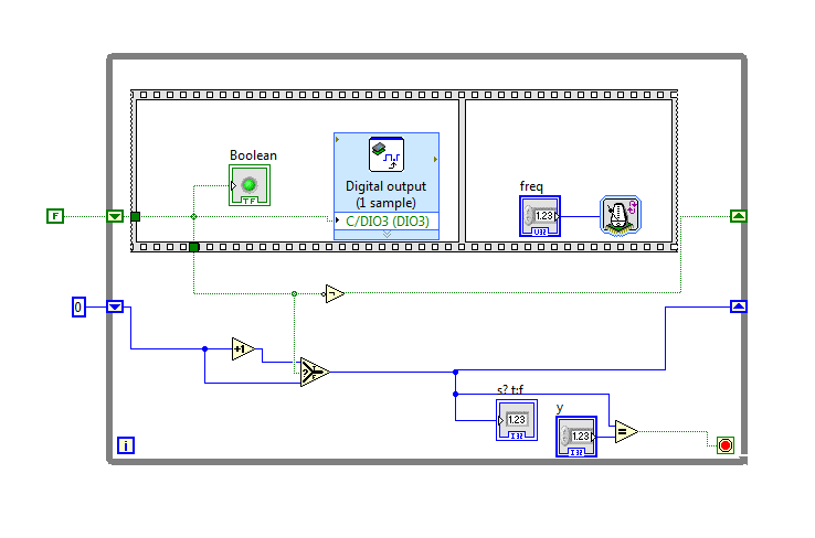

i want to control 3 drivers and the input of them is pulses
i want to control numper of pulses and the freq.
Message 4 of 11
(5,595 Views)
i'm already tried something like that but i will try this too especially on the high freq.

Hi ammar,
Then why don't you show your VI?
Define "high" frequency! What are we talking about?
- The myRIO surely comes with a lot of example VIs after installing LabVIEW with all modules/drivers. Aren't there any examples on using the DIO pins?
- Are you able to use the FPGA? It will allow "high" frequencies!

Hi ammar,
why do you use all those (shared) variables (introducing race conditions)?
In the myRIO you should be able to use TimedWhileLoops with higher clock rates then 1kHz.
But in general you should create a PWM signal (or a pulse train) when outputting a number of pulses!

Hi ammar,
please don't send PMs for stuff related to your threads in the forum!
When you have new information post it here so all can see it and provide answers to you!
What should we do with this image? We don't know your control values nor do we know the settings of the Wait function!
So I conclude: It's nice you can reach 10kHz with this loop…
