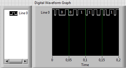

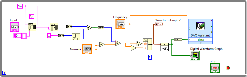

About 3 weeks ago, I asked for help for generating rectangular pulses here and as shown in the two below pictures, everything was alright.
However, my receiver disagrees : he doesn't want rectangular pulses so I need to change it for a sine pulses.
I've tried to use the function Get Waveform Components (digital waveform) and to multiply it with a sine of the same frequency but I can't multiply an array digital data with an array of double.
Thanks for your help.

Yes of course.
My input is a string of 0 and 1 : it's arandom sequence that I describe as random bits.
Once these parsed, I'm creating a rectangular signal as my second png shows and I'm sending these through the channel as you guessed.
My point is to convert the rectangular signal into sine before sending it into the channel so that the filter of my receiver becomes happy receiving sine and rectangular signals

Do you want to smoothen your pulse signals? If you have random bits you cannot convert that to a sine pattern since sine wave is periodic. Also when you say 0 and 1 what will be the voltage levels when it goes out of the DAC channel? Is it 0 and 5V ot 0 to 1 V?
Message 6 of 9
(5,136 Views)
The conversion is 0V for 0 and 5V for 1.
Yes the point is to smmothen the pulse signal, do you know any way to do it ?
My last option (the brutal one) is to add a RC circuit and play with the impedance to create something smooth but if I can avoid that it would be nice.
