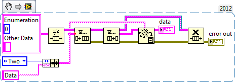

I seem to run into this problem sometimes, where I find several nearly identical SubVIs accepting queues that are slightly different. The queues use different enums, although all the enums are in fact just 16 bit integers. To reduce code I would like to combine these SubVIs into a single SubVI. My only obstacle is this slightly different queue type used by each SubVI.
Is this possible without converting all VIs calling the SubVIs to use a queue type containing variants, like you suggested? I was hoping there might be a simpler solution since all queue types use the same underlying datatype (16 bit integer) even though the enum is different.
Thank you!
Message 27 of 29
(3,545 Views)
In this specific case, just make the queue contain a 16-bit value instead of the enumeration. You can do this even if the enumeration is part of a cluster; it will adapt automatically as shown here:
When you dequeue, you can treat the integer as an enum and let LabVIEW coerce it automatically, or you can do it explicity as shown here with variant to data.
Message 28 of 29
(3,536 Views)
You will also need to know which enum is used in each case so that you can properly Typecast back to the correct enum.
In the attached VI the cluster contains an unsigned integer to transmit the enum value. The string passes the name of the enum (or perhaps the name of the typedef) which is used in the "decoder" to select the appropriate enum to recover the data. Note the coercion dots at the Bundle by Name "from_enum" inputs and that there are no coercion dots at the outputs.
