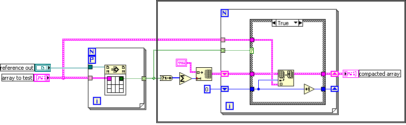

Is there a way to do the following (or at least this stuff in the box) generically. Is there a name for this algorithm?
Essentially I want to reduce an array to just its elements that pass a test. The test can just be another array of booleans which say whether the array passed the test or not. I feel like I write this code a lot and it bothers me that I write it so much.

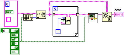

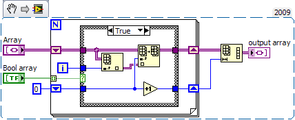

Let me suggest the slightly more clever approach shown below, where you re-use the input array.  If you make this into a subVI with the input as an array of variants, you can use it on any type of data at the cost of adding Variant to Data after the subVI call.  Conversion to and from variants incurs minimal and will have little effect on performance.

My hope was that no variants would be necessary at all as they add clutter and bypass compile time type checking. Clearly one way to make functions like this generic is to use variant data. I was kinda hoping to avoid it all together. The reason I wrote out the function the way I did is because it's space and time efficient in more cases, generally.
It's true you're probably fine doing this in one loop (using a preallocated array with the same size as the input array). Consider though that if you want to avoid making a full sized copy of the array, generally, seperating out the loops is needed. Labview doesn't make a copy of any array data until it passes the data into the test function (and if the test function isn't even a vi then it doesn't make a copy at all) which it will only do one or P at a time, depending. Then the only new allocation of significance is the allocation by initialize array, which in many cases will be substantially smaller than the input array.
