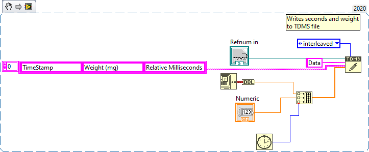

Not sure what is causing the error, but maybe trying writing the data all at once. (Guessing it is the dynamic data type) You will need to convert from Epoch time.(See Below) Also recommend not writing a single set of points at a time, not shown, write multiple values at once.
