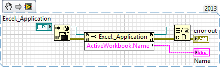

Why don't you use ActiveX? This following code gives you the name of the active workbook.
Ben64

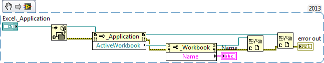

Ben,  I little micronugget for you.
Smiley Surprised
WHAT! How did I do that with one P-Node.!
When you create the property node and right click to select a property- choose Browse... (right at the top) any properties that return references can be expanded until you get the property you are really interested in.  Expert TIP: choose Name Format.Long Names when you do this to make the code more readable.  The BD cost is minimal compared to having multiple P-nodes with short names.
