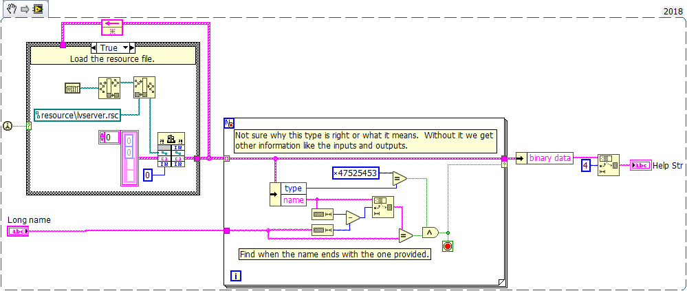

But I'm trying to get method-specific help to show.  My guess is that some kind of suffix on the tag would do it, but I haven't been able to guess it.  I can do this (thanks to Hooovah) to get the help description for a method:
mh.pngHowever this doesn't get me to the detailed help page.

I don't have that snippet handy, I've misplaced my working drive (I'm not in a panic because I backup important stuff every few days).
Here's what Hooovah sent me.
