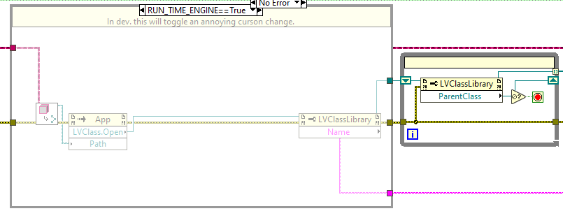

@LucianM wrote:
Thanks Wiebe, I know about that thread. The solution presented there does not work in run-time. I need it to work in run-time because we have a test sequencer developed in LabVIEW which is able to execute class method VIs but when dynamic dispatch VI is called and the current class does not have an implementation for that method, I needed the parent to check if it has that method implemented and call it.
You can use this during Run Time.
It works during development, but you'll get an annoying wait cursor when you call it.
