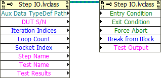

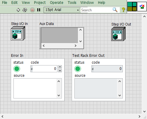

For what it's worth, here's how I'm doing things:
Each step in a sequence is an object.  It references 0 or more code modules to be called.  It also optionally references a typedef for an Aux Data input to the code module, and the step also has a variant that contains the value for that custom data.  My step-settings dialog presents that step-specific custom data typedef in a sub-panel, and keeps it synced to the value in the variant.  The template for code modules looks like this:
All code modules must have the same connector pane.  In each code module, the "Aux Data" control is replaced by the custom typedef for the step (the step settings dialog keeps it synced with the step settings in the sequence).  The code that invokes a step, copies the custom data from the sequence step to the "Aux Data" control in the code module before calling the it (the code module is called by reference so the executive won't abort if the code module aborts).
The Step IO class has a set of properties that are available to all steps:
So far, my hierarchy of step classes looks like this:
