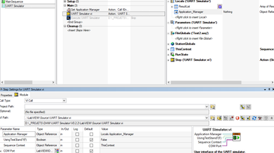

I want to retrieve on LabVIEW the Application Manager of TestStand.
The point of that is to create a TestStand UserEvent to communicate with TestStand with UIMessage and get data from running sequence.
My LabVIEW code is going to run as an executable so I just can't get the Application Manager on TestStand, then call my code through the LabVIEW adapter and give it the ref of the Application Manager just as below :
I tried to pass the Application Manager as a arguments with the step "Call Executable" but it didn't work (I can only pass strings and the type cast doesn't work) => Maybe I miss something, if so, just tell me ^^

Hi TenJigoku77,
What do you mean by "it didn't work"? Did you get any error?
By looking at your screenshot, I think that maybe there is a mismatch between what you get using the ActiveX steps and what your LabVIEW code module is expected.
Can you send a screenshot of the step settings of the ActiveX Action steps?

Hi Clement,
Thanks for your answer.
My activeX module is working fine, I really get the application manager, I can pass it to a LabVIEW module and normally use property and invoke node.
But don't want to use a LabVIEW module because it has many dependencies (risk for the user to delete files) so I prefer launching an .exe.
So I decided to compile and launch this .exe with input command lines :
I tried to cast the application manager into string in order to pass it in command line. But when I read the command line in the .exe, cast it into the object "application manager", then use property node or whatever it send me an error ("the object is not a valid ref...").
This is what I meant with "it didn't work" => I can't transfer the application manager from teststand to a LabVIEW exe (I tried with files).
