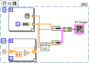

You could take the 64000 data points and interpolate between each point.
Use the 64000 data points as a lookup table. See example.
The top for loop is 5 datapoints... I want 10 datapoints (bottom for loop).

ADrexelDragon What is the function used with next to the bottom loop and where is it? I can't find it anywhere :S

I think it is interpolate 1D.vi, from the "mathematics...interpolation palette". (Nothing to do with serial...)
Also note that the above png picture is actually a LabVIEW 2012 code snippet, meaning you can drop it onto the diagram and it will magically turn into functional code. Try it if you have LabVIEW 2012..

Yes I used the 1D interpolation to generate in between data points. I posted the wrong function before. Sorry about that.
