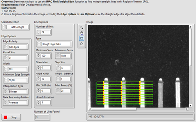

I would like to find all edges find in a rectangular roi.
I have tried to use this example:
The problem is that this VI "straigh edge detection" just find some of edges, not of all them. In the image this vi have found 3 lines, and I would like to detect 6 lines because there are 6 lines to detect in the rectangular roi.
Is there any way to do this?
Thanks a lot.

Hi, thanks for your help.
If I use "Best edge projection" then tool find just 1 edge in 1 line, I would like to find all of edgest with step option. I mean, some cheking line in horizontal (it depends on step option) and then find all of edges that there are acroos these lines.
Thanks a lot.

I would encourage you to try out the algorithm in Vision Assistant first, to see which one works best for you. Open your image in Vision Assistant, then select the Adv. Straight Edge step located in the Machine Vision palette.
Select either the Best Hough Edge Rake, First or Best Edge Projection detection methods. Those are the ones that will allow you to detect multiple edges.
Draw your ROI, then uncheck the Suggest Value checkbox.
Select the Straight Edge Settings tab, then increase the Straight Edge Requested value to the number of edges you want to find.
Adjust other parameters if needed, based on the edge strength profile displayed.
When you're satisfied with the results, click OK, then Tools>>Create LabVIEW VI to create the code corresponding to this algorithm.
