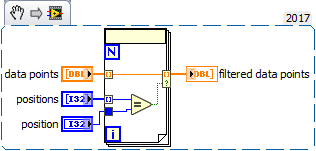

Hi nikvl,
after creating the arrays for timestamps and "data point" you also should create an array of "position".
Then feed all 3 arrays into a FOR loop containing a simple comparison with desired "position" value. Then use conditional output tunnels to create filtered arrays of timestamp and "data points"…
Example:
(3,152 Views)
I had to tweak some things and add an extra for loop but it worked wonderfully. Thanks!
