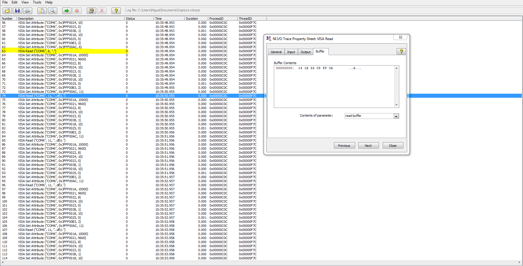

In order to work out why you are receiving data in this way, I would use I/O Trace:
http://digital.ni.com/public.nsf/allkb/282C5D41E2BA04F2862574BA007803B9
Once you have the capture, with the VISA Read function in the trace, right click and select properties, under buffer you will see exactly what VISA received.

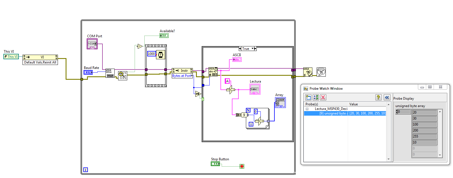

Doing what you say, I have seen in a first moment the program receive one data and after this the program receive other data. In the follow picture you can see it.

I have extracted the serial port initialization before the while loop, but the program responds on the same way. In a first moment I can receive the value 10 in the correct position, but when the next package is received, this changes its position to the last.
