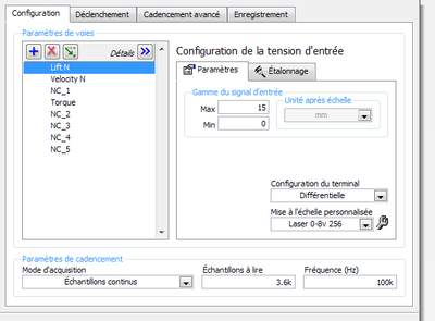

I'm using an external clock for AI task.
as follow:
This is an AVL Encodeur with 360slits .
I perfectly get each AI measurement every degree. I would like to know the time between each slits from my external clock. Of course I would like it synchronised with the AI channel.
Ex 3.6k sample read.

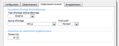

Some VI and Max configuration.

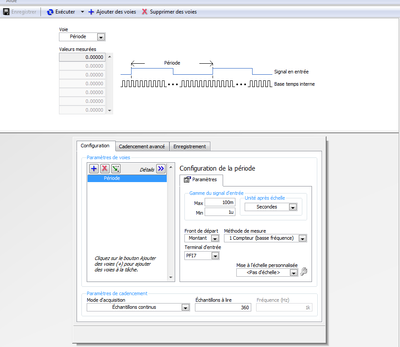

I have a new question the time ellapsed betwen pulse (dt), and the the analog input are not synchronized.
The data aquisition works very well.
Is there a solution to solve my problem?
I think that the start of counter and acquisition is not the same.
This is the 2 task I m using in max.
PFI 13 is  the big teeth on the encoder (one per rev)
PFI 12 is the 359 small teeth from the encoder
Many thanks and best regards,

I think the start time for the both acquisition (counter and AI) are not the same.
Signal of the 2 task are correct but not at the same start time.
Attached the view of the max config to help understanding of what is defined.
Also Attached the VI. I created task with labview assistant with exactly same parameter i'm normaly running. I modified nothing to prevent...mistakes
Julien
