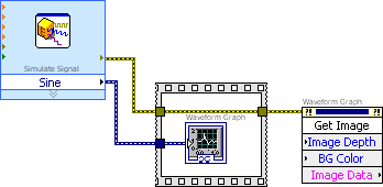

Have you tried something like this?
Good luck

Add 100ms delay in the structure where you have kept the graph and check whether it works or not may be the graph may take in ms to update the value in it but your execution is happening in ticks so try this I believe this should solve your issue.
