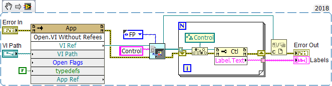

If you don't mind brown methods, try this.

Hi Paul,
Brown nodes are mandatory 🙂
Sadely, I got an error 1026: VI Reference is invalid.
The VI I try to analyze does not have separated compile code but relies on sub VIs that have separated compile code.
Amaury.
