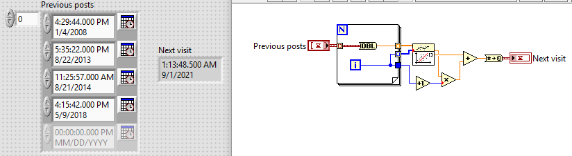

I did a linear fit that estimates he'll be back here at 1:13 AM, September 1st 2021.
