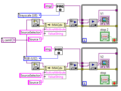

I have a GigE camera that has two CMOS sensors from JAI. In LabVIEW and NI MAX I was able to select the video stream from one of two sensors. However, I would like to view both video streams simultaneously. I tried the option shown in the figure, but it still only shows one video stream. What would be the general strategy to approach this problem? Thank you for your time answering my question!

LabVIEW Vision, particularly IMAQdx, appears to be tied to the GenICam standards, which many manufacturers of cameras support.  I don't know if "dual sensors" are part of the standard -- if not, IMAQdx might not work.
Can you set up the camera (in MAX) to capture videos from each Sensor?  What do you need to do to specify which sensor is "active"?  What does the Manufacturer say about using them simultaneously?  [I presume that they have custom software they'd like you to use, but they might also have "hooks" into their code for C++ that might give you some clues].
