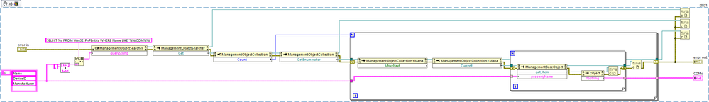

Never mind, I posted too fast and I figured it out. You can use WMI using .net functions. I'll leave my quick prototype here in case anyone is interested. 
