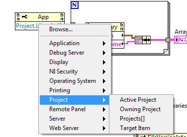

I tried using the Project.Libraries[] property node but it neve returned any references. It was strange because I enabled scripting, but I still can't see that item under the property node of App. I copied and pasted the snippet you provided and the VI compiled, but as you see below it still does not appear as an option.
I am using these packed project libraries as plugins. I am trying to get the version number of the ppl from a VI inside the PPL. I can work with getting the version number from a VI outside the PPL, so far I just can't seem to get a version number that is not the executable.

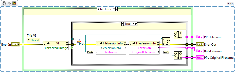

I have been able to retrieve the PPL version programtically at run-time with no issue. It requires adding an extra VI to the project library so that it can interrogate itself:
Message 7 of 9
(9,078 Views)
This same basic logic also works from outside the PPL as well. All you have to do is pass into it a reference to a VI that is in the PPL, and everything else just works.
