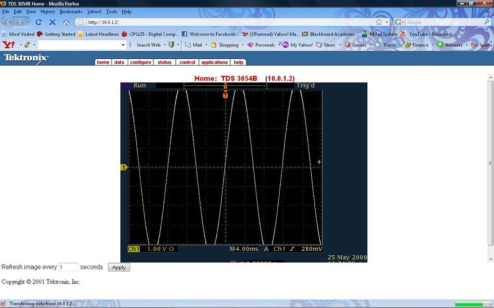

I'm a new user of LabVIEW. I'm currently working with oscilloscopes which are mainly in the tektronix TDS 3000B series. I'm trying to get the waveform data from the scopes from their assigned IP addresses just so I can access them whereever I am in the lab that I'm working in.This is what I have so far:
I just want to get this waveform be saved through LabVIEW and I have no clue whatsoever where to start.

Go to the Instrument Driver Network and search for your model. Download the driver if it exists. On the same page, check the information on what a driver is and how to use one.
You can add the scope in MAX. Right click on Devices and Interfaces and select Create New>TCP/IP resource and follow the directions.
