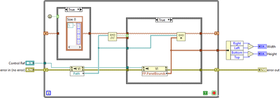

Accepted by topic author carls__
For completeness, calling a VI that does this before attaching each control seems to be doing the trick (so far):

Maybe if you set the called VI to "preallocated reentrant" and spawned a new clone for each call it would always return the default "saved" panel size.  I'm guessing the panel itself would also lose any post-runtime user size changes.  A roundabout way to accomplish what you are looking for is maybe to have the very first spawned clone as the "master VI" (keep track of reference, do not close/release) and all subsequent clones are only quickly spawned (maybe set as hidden or transparent), property read of default panel size, then the reference destroyed.
Cached approach is probably easier; but like you say the default panel size has to be stored somewhere in the VI itself.  The reentrant clone approach is the only way I can think to get at it at runtime.
