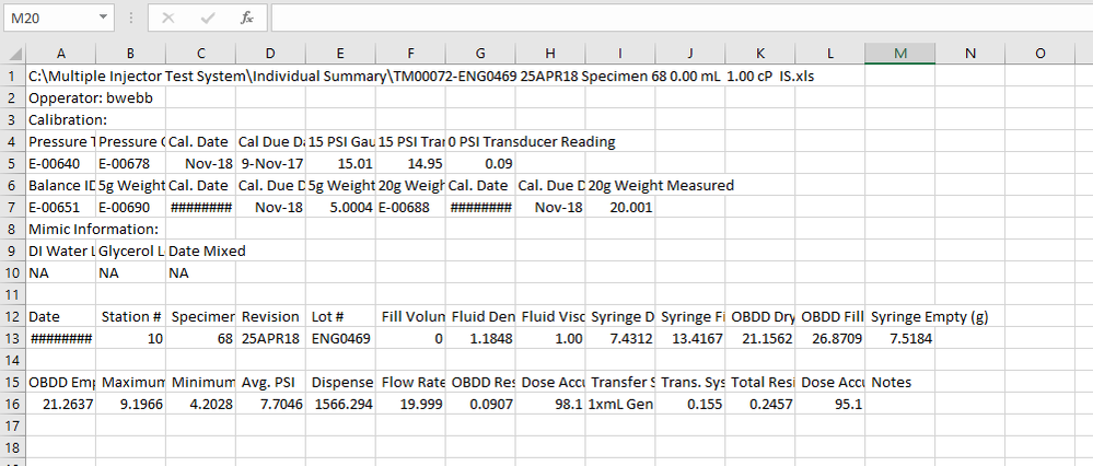

I have a program that writes data collected to an Excel spread sheet as a single string with formatting characters,( ‘\’ codes). The unformatted data looks like this.
 Now the challenge is to format the Excel sheet into a finished report. I would like to do this using a template. I have not had much luck using the report generation tool kit.

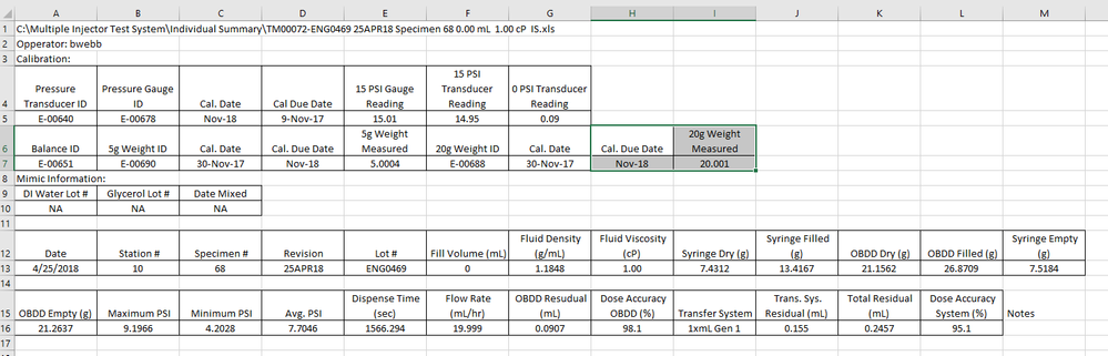

I would like it to look like this.
I would like to open the template, append the line of text containing ‘\’ code,  starting at A,1.

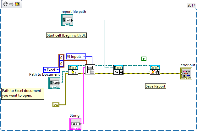

Thank you for all the help so far. This is the test program I have been playing with. The problem appears to be that the Excel Easy Text .vi will not handle the '\' code.
Here the text code if it does not come through the snippet, (first time posting one).
Opperator:\sJames\sHappe\rCalibration:\rPressure\sTransducer\sID\tPressure\sGauge\sID\tCal.\sDate\tCal\sDue\sDate\t15\sPSI\sGauge\sReading\s\t15\sPSI\sTransducer\sReading\t0\sPSI\sTransducer\sReading\t\rE-00640\tE-00678\tNov\s2018\t09\sNov\s2017\t15.05\t15.04\t-0.02\t\rBalance\sID\t5g\sWeight\sID\tCal.\sDate\tCal.\sDue\sDate\t5g\sWeight\sMeasured\t20g\sWeight\sID\tCal.\sDate\tCal.\sDue\sDate\t20g\sWeight\sMeasured\rE-00651\tE-00690\t30\sNov\s2017\tNov\s2018\t5.0003\tE-00688\t30\sNov\s2017\tNov\s2018\t20.0010\rMimic\sInformation:\rDI\sWater\sLot\s#\tGlycerol\sLot\s#\tDate\sMixed\r\nH023-09\tNA\tNA\r\n\rDate\t\sStation\s#\t\sSpecimen\s#\t\sRevision\t\sLot\s#\t\sFill\sVolume\s(mL)\t\sFluid\sDensity\s(g/mL)\t\sFluid\sViscosity\s(cP)\t\sSyringe\sDry\s(g)\t\sSyringe\sFilled\s(g)\t\sOBDD\sDry\s(g)\t\sOBDD\sFilled\s(g)\t\sSyringe\sEmpty\s(g)\s\t\r5/30/2018\t3.000000\t\s663-5\t\s\t\stest\sComparison\s16MAY18\t\s10\t\s1.0000\t1.0000\t8.9268\t18.8705\t21.1711\t31.1137\t8.9254\r\rOBDD\sEmpty\s(g)\t\sMaximum\sPSI\t\sMinimum\sPSI\t\sAvg.\sPSI\t\sDispense\sTime\s(sec)\t\sFlow\sRate\s(mL/hr)\t\sOBDD\sResudual\s(mL)\t\sDose\sAccuracy\sOBDD\s(%)\t\sTransfer\sSystem\s\t\sTrans.\sSys.\sResidual\s(mL)\t\sTotal\sResidual\s(mL)\t\sDose\sAccuracy\sSystem\s(%)\t\sNotes\r21.2851\t17.4203\t2.9948\t10.5613\t179.4780\t197.144\s\t0.1140\s\t98.9\t\t0.0025\t0.1165\s\t98.8\t\s

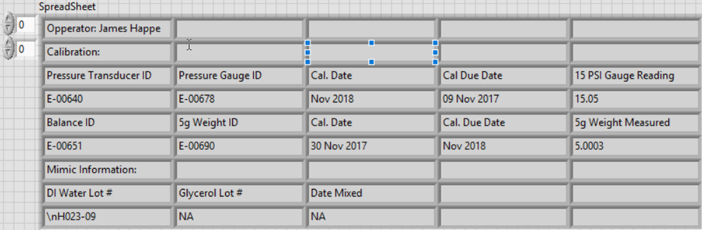

You may be going about this in the "wrong way".  I copied your String into a Text File, then opened it with LabVIEW and read it -- it created a long string with embedded \s, \t, and \r characters.  I used three Search and Replace String functions to replace them respectively with a Space Character, a Tab Character, and an End-of-Line Constant.  I then noticed that I essentially had a Tab-Delimited String, so I then passed it through the SpreadSheet String to Array function and got the following:
Looks pretty close, right?  In fact, if you took this array and wrote it using Write Delimited Spreadsheet to a file with the extension ".csv", you could open it with Excel (which "knows how" to open Comma-Delimited-Values files, and, indeed, hijacks the extension to give it an Excel-like icon).  You could also (probably) use the RGT, instead, to write out this entire array as a true .xlsx file, ignoring the need for a Template (since you have almost everything in this file).
There is, however, one "gotcha" -- see the cell in the lower left corner?  It starts with \n, meaning that a few of your strings use \r for EOL, some use \r\n (and leave an "orphan" \n over), and some may use \n by itself.  This makes the parsing a little trickier, but that I leave as an Exercise for the Original Poster ...
