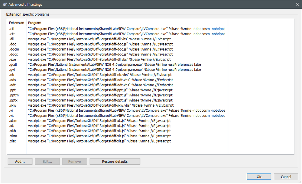

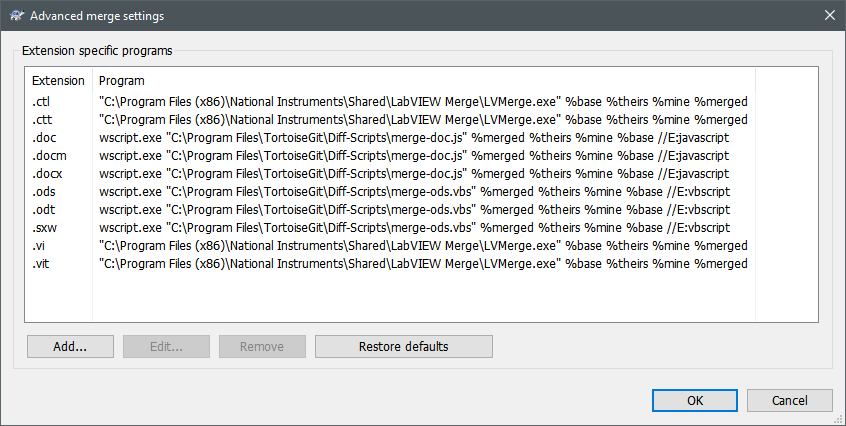

Like thols wrote, make sure Git is handling the LabVIEW files as binary files. For Merge and Diff you can configure Tortoise Git to use the LVCompare.exe and LVMerge.exe that comes with the LabView installation. All you have to do is add the tools to Tortoise Git like this:
There is also a ready to use .gitignore file here: https://github.com/github/gitignore/blob/master/LabVIEW.gitignore
With all this done, using Git is no problem at all.
