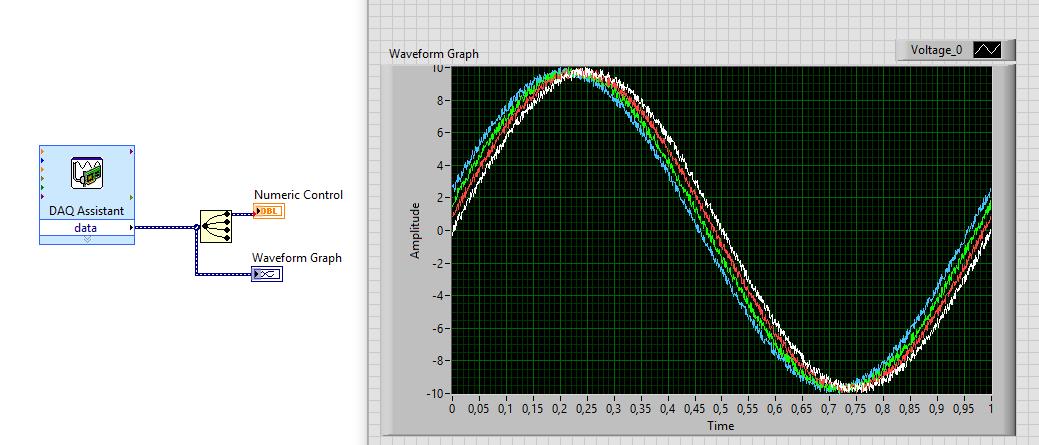

Basically, your signal is composed of the four different values.
What you could do is to use a Split Signals * function and output the (4) values that you read.
*(ctrl + H, then type Split Signals)
Does this reply to your question?
