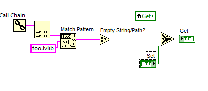

Hi Jeff,
Something like this?
Tom L.

I'd rather break any vi that tries to set the value out of scope.
