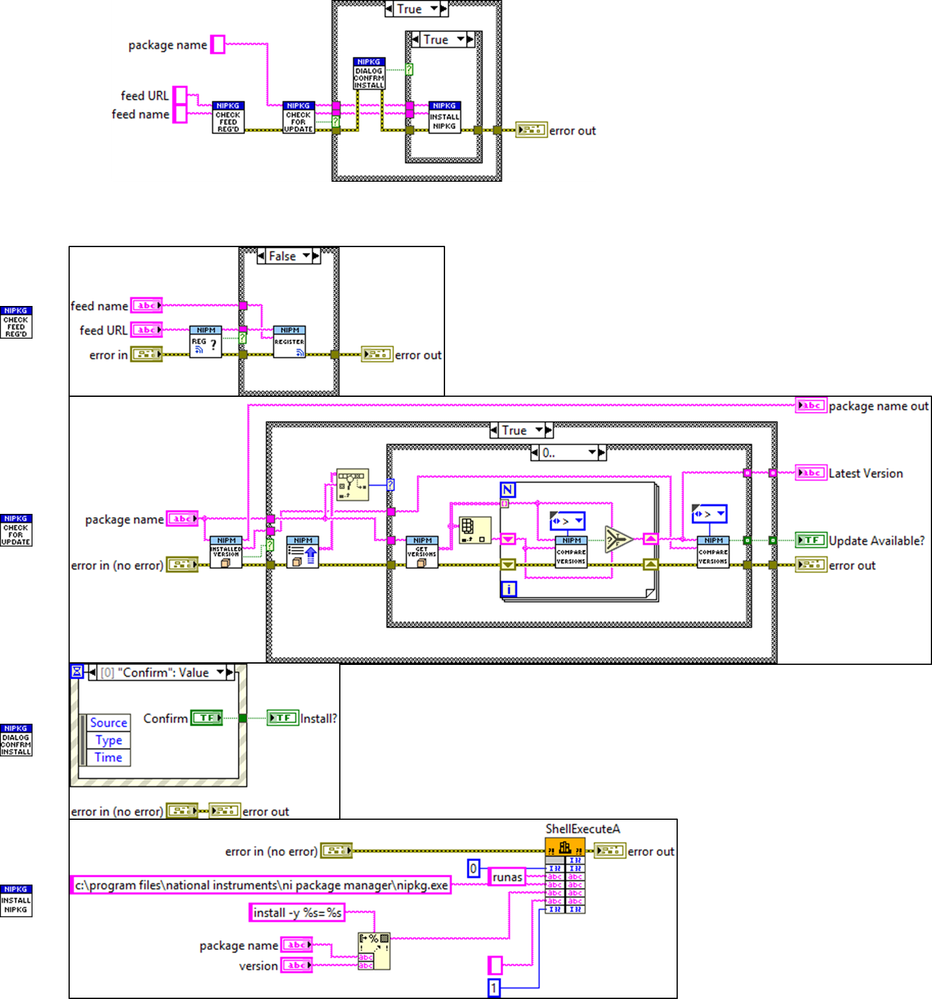

I found the NIPM API a little lacking in 2 features. First, "Get Versions" is supposed to return an ordered list, from highest version to lowest, but I did not find this to be the case, so I have to find the highest version from the list. Next, installing the package requires running the command prompt as an admin (on my Windows 10 machine), so using their provided "Install Package" did not do anything, you can see the run as admin version below.
Thanks for your thoughts! Below is a picture of the code, but if you have LV 2016 you can download the attached zip file to play with it.

Well, it turns out running a package update while you are running an executable from that package is no good. NIPM will think that it updated, but in fact the executable was not updated.
I have decided to create a separate executable which looks for updates. It can check if the original application is running using the tasklist command, and tells the user to close the application before trying to update. It kind of runs in the background using the ini key "HideRootWindow = True". I have also used the ini key "allowmultipleinstances = TRUE" since this executable is on the network and could be called by several applications at once.
