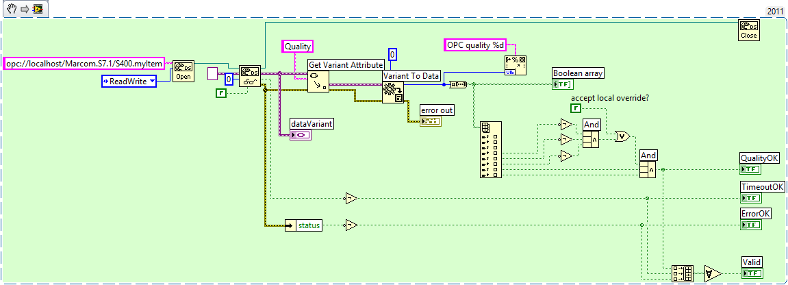

To read/write PLC items I simply use Datasocket functions with a DA OPC server (NI OPC would be ok I guess).
Here is an example of reading a generic item. It can be a variable or even a memory block.
The URL string depends on the OPC server. The trick is to read the item as a variant, then get the OPC Quality as a variant attribute. At last you need to convert the variant to the proper data type; a memory block would be converted to a LabVIEW cluster.
This is a simple example. In a real program, you would open the connection once and use it many times.Read OPC item example.png
Paolo

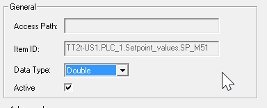

pincpanter, tried your example with NI OPC server, but did not know how to construct a proper opc-URL. In NI-OPC-QC (quick client) one example variable looks like. Tried to use these data with your url structure (and with backslash and dots instead of slash). Can you explain how do this?
