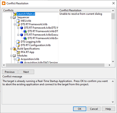

I keep getting this dialog on deployment.

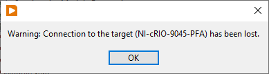

The next issue is that clicking OK on that dialog always leads to this next one.
Which leads to...

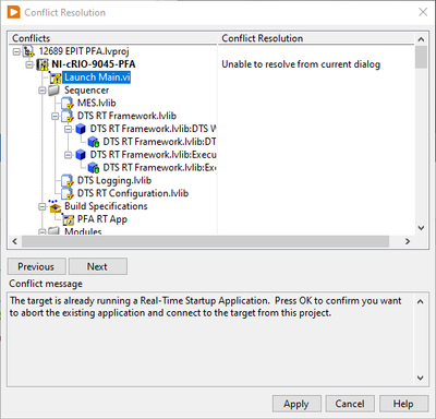

...making me have to do the Deploy again. That brings up this one which is somewhat similar to the first, but this time there is an Apply button.

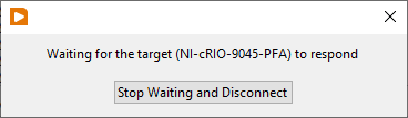

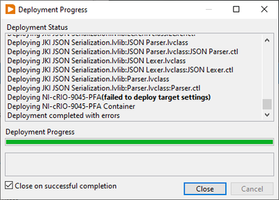

At that point, I see some Deployment progress with a bunch of files scrolling by. Often, I also see the Waiting dialog like this.
After that, the deployment succeeds we reboot the cRIO to run the new Startup Application.

However, that is not the issue I am describing. My issue happens on Deploy. It is being caused mostly from the fact that there is already an executable running. In the past the applications I have deployed have been tolerant of being terminated when a new version is being deployed. These recent ones are less so. It might have something to do with the EtherCAT stuff that we have or something like that.
I understand the need for a dialog to confirm that we want to terminate the execution of a running application prior to deployment. I do not understand why it doesn't succeed in "Updating settings" the first time and then drops the connection.

The issue I am having on LabVIEW 2020 SP1 is that the Deploy will complete with errors (failed to deploy target settings). That includes the Deploy that is required in order to "Unset as Startup". I can work it through the same way as before by repeating the Deploy, but then instead of one reboot I get to wait through two. I'm trying to figure out if there is a way to deploy a new build knowing that a reboot is required, but without going through the whole bunch of waiting and dialogs and repeating the Deploy command twice.
