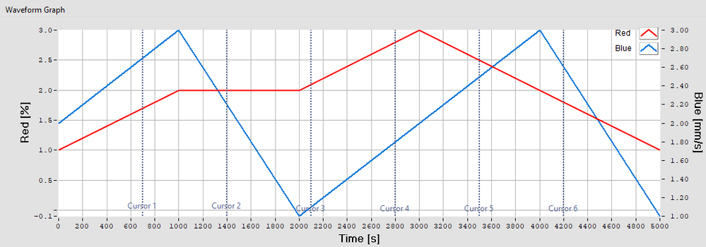

This is a graph with cursors. Each cursor has a name that sticks to its position relative to the cursor.
How can positions of these names be changed?
Internet says there is a property related to offset of the legend but I cannot find such a property.
Thank you.

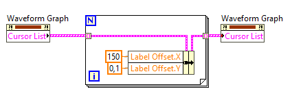

Read property "Cursor List", modify "Label Offset" of the desired cursor(s), then rewrite the whole property.
Also, X and Y offsets are expressed in the same units as the cursor's X scale and Y scale respectively.
