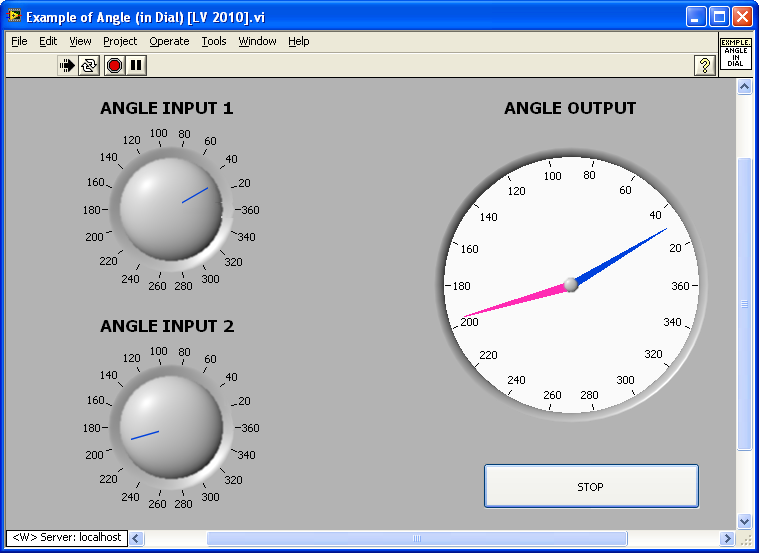

I am wondering if there is anyway to make such graphs in Labview. I have readings of angles, and I would like to show them in such a graph.

I dont know how exactly you want it to be displayed in Graph... But the picture you shared, based on that I tried making (customized an existing) similar Front Panel object.
This is customized using Dials (which is available in Controls Palette).

Thank you so much for your kind help!!! That is exactly what I wanted!!! :womanvery-happy:
Could I ask if there is a way to replace 360 with 0? And probably change the colour and style of the graph? I could only change the colour of the needles and set 360 to the top.
In addition, do you think there is anyway to create a half graph for the inclination, like the one posted?
