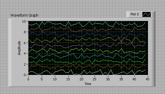

2D array is all you need 🙂
This high-end code
Will produce this graph
If, on the other hand, you need a chart or some XY graph/chart, then you need something else 🙂
