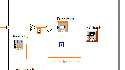

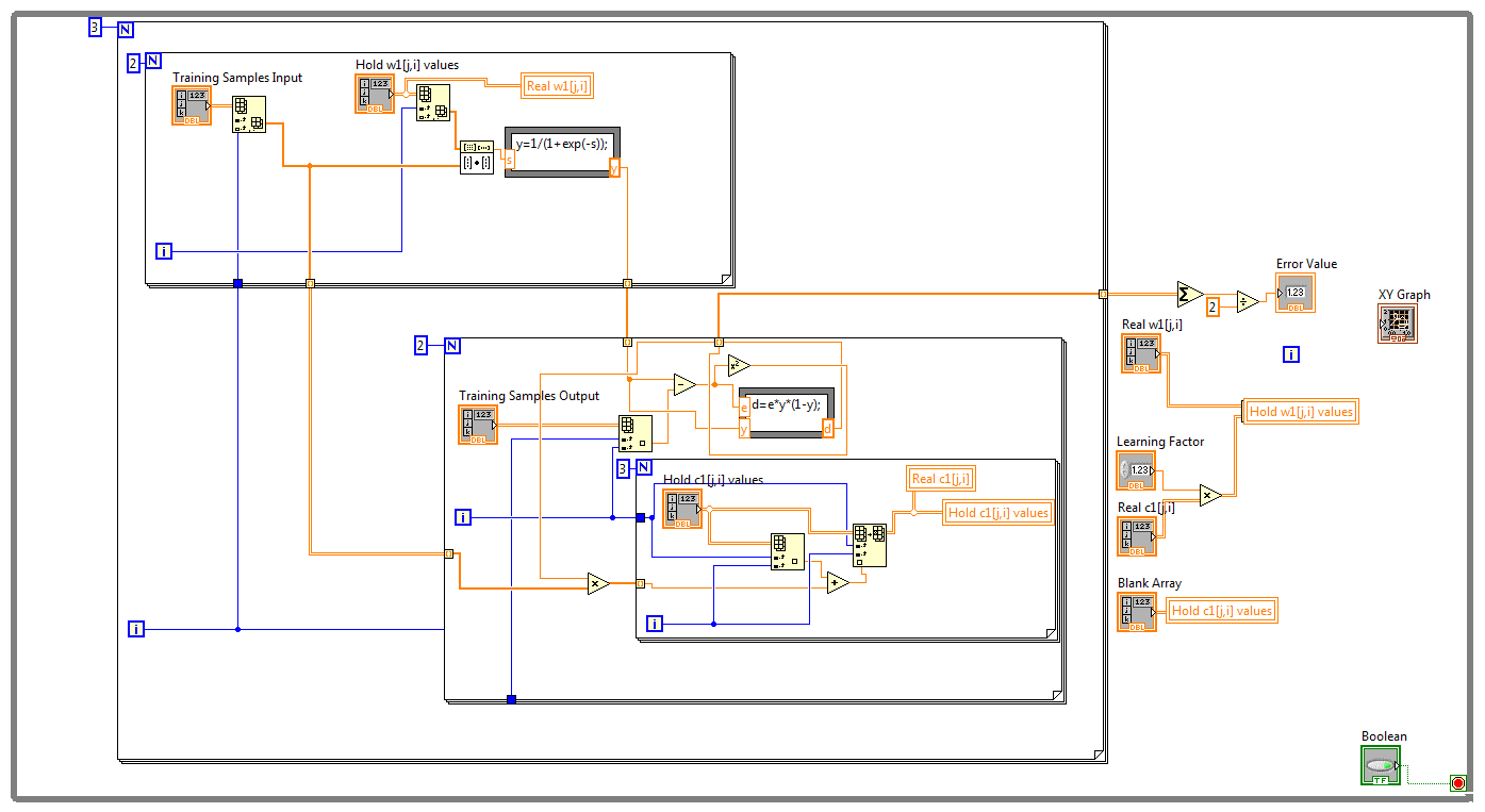

So basically I want to graph the 'Error Value' with respect to epochs (iterations of the while loop) and I can't seem to get it to hook up right (it's been awhile since I've used the graphs in labview).  I'm not sure if I should be using an XY Graph or a Waveform graph, or how it needs to be hooked up (arrays, clusters, etc).  Does the graph node need to be outside of the while loop?

why don't you attach the complete VI, is the for loop inside the while loop?

Here is the complete vi

I actually expected you to attach the VI file.
Note that this is not exactly your exmaple, but I have given you what you exactly need, taking the XY graph outside the while loop, and adding 1 to the i terminal of the while loop, since the epoch will start at 1.
