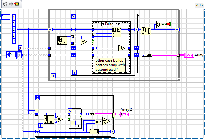

Group Equal Values
Was just curious if there was a more efficient way to get the same functionality, maybe something without the reshaping of an array on every loop iteration.

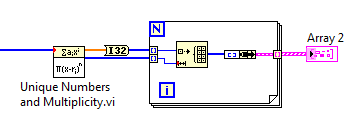

Try this one on for size...
Message 4 of 18
(5,585 Views)
Don, that's awesome, but unfortunately if you read my comment above, won't work for my exact situation. That will definitely be added to my "toolbox" however.

I think this is sort of where Tst was heading.  Not completely sure.  But instead of reshaping the array to make it smaller, set the N on the FOR loop so it only iterates over the first N samples.  It took about a third of the time for me.

In 2013 this postage stamp should be rather effecient as all array data changeing operations are eliminated except the conditional tunnel (that was fixed in 2013 right?)
I'm not really set up on a benchmark ready system-- but you are welcome to try
