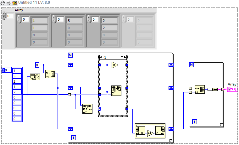

Ok, so after dinner I decided to go back to this and play.  I am pretty sure this is what Tst was trying to say.  I am using the original array in order to build up my grouped arrays.  I then keep track of how many elements are valid in the grouped array.  Use Replace Array Subset to add to the group and then Array Subset at the end to only have the valid elements.  I learned this trick while trying to help with OpenG last year.
I also found some issues with the way I was doing benchmarks.  So Greg's original was not as bad as I first thought.  But Jeff's was worse.  But in the end, here is what I ended up with.

Actually, what I suggested was something like this:
The top array holds the values we already found and the bottom array holds the count for each value.
What's nice about this is that it's very simple and that it has no while loops and no dynamic building. It iterates over each element exactly once. What's not as nice about it is that it creates two additional buffers of size N, which might be an issue if N is large.

I should probably point out that mine has a bug - it will fail to correctly handle values which are 0, because they're already in the initialized array. You can handle this by using an invalid value or using Array Subset before searching the array. The Array Subset option should probably also improve performance because if a value is not in the array, you have to iterate through fewer elements (or you could use variant attributes for just that part of the search).
