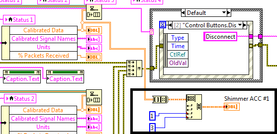

I started with one Shimmer Wireless Sensor Unit configured as accelerometer. For Shimmer 1 (in "Four Shimmer Write.vi") modified file "Four Shimmer Write.vi" looks like this:
According to "Shimmer 9DoF Calibration Application – User Manual, page 52" I selected columns 1 to 3 to display acceleration in three axes. It works fine.

If you enable both the accelerometer and gyroscope using the front panel controls then you should have 7 columns of data in the calibrated data array. Column 0 is the timestamp, columns 1,2 and 3 are the accelerometer (you seem to hve this part figured out) and columns 4, 5 and 6 will be the gyroscope data.
