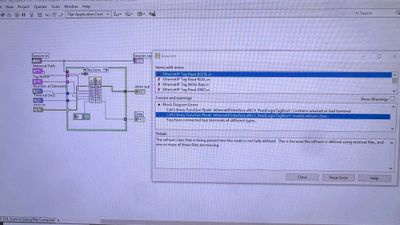

recently i had a HD crash on a windows XP machine . I had another windows 10 PC and was able to recover the code from old PC which was Windows XP. I am stick with the current issue with a picture attached. I am not able to figure out with the ethernet ip interface why the session in does not match in labview 2017 but it does in labview 2010. Any help would be appreciated.

I did install the ethernet ip toolkit, i was able to find the .dll file and point to the right location it cleared some errors . Still in the code i have broken VI call library function, specifically the ethernet session io.
One error is invalid ref number class
Two terminals of different types ( keep in mine i was able to get this to work on 2010 version but no luck on 2017)
And last error of course unwired terminal

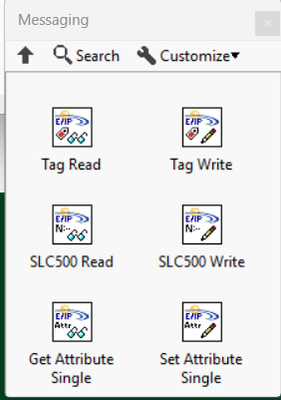

Looks like you just need to replace the broken VI with a new version in the palette. See below:
When I use the one from this palette it is not broken.

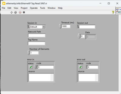

I must be missing a file or something, i even tried creating a new Vi with just the messaging read and once i open the front panel of the VI it is still broken. Somehow i need to find the difference between the two machines one has labview 2010 and one has labview 2017.

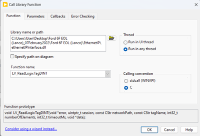

When I followed the DLL path in your attached VI it was to a user folder. Someone must have copied the dll into the project or folder. I would start by deleting the dll in the folder and finding the one in the vilib folder.
Use this one:
The block diagram for this one is password protected. Delete the old one and restart your program or open the project manager.

i have tried this several times, and i still dont have the option for "INDUSTRIAL COMMUNICATION" in my functions pallet . And i have downloaded the package for the industrial/ethernet communication through NI Package Manager. I think if i finally have this option and replace the old Vis with the new Vis it will work. I appreciate everyone support and comments, I will keep trying !!
