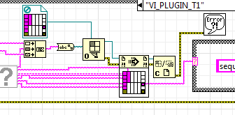

Look at the error message.  It tells you that the error is occurring in "SeqUUTCmd.vi".  No one can help you resolve the error because you haven't provided the VI that is throwing the error.

OK That helps us help you
To "Be a Test" within that framework the connector pane must match THIS pattern
All the inputs and outputs must be of the same type as that pattern
they must have the same options set (Required / Recommended / Optional)
And the connector pane cannot be flipped either horizontally or vertically nor rotated at all.
