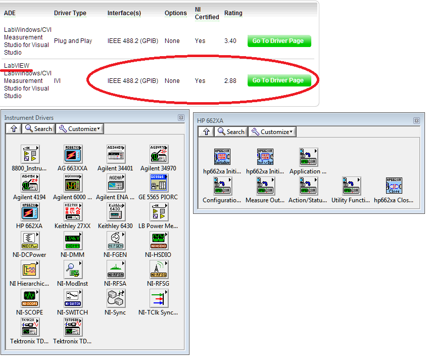

Hi noobie_program…
If you use the this link and download the second driver, it will download an installer with the extension exe after you install the executable and open LabVIEW you should be able to see the driver in function palette of the block diagram. In the instrument I/O>> Instrument driver >>HP662x
Regards Esteban R.
